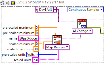

Create a scale?
Jim
Message 3 of 13
(11,946 Views)
Use scales in  NI MAX to get your output from the task (Your task should be set up in MAX) to display the units that you want.  ie, 0-5 vdc on 0-30 psi gauge, scale slope would be 6.  You can create a more customized scale if you need to account for any linearity issues with the transducer. The Omega's are ususally pretty decent.

Your scales look fine.  Your next step is to set up a task in MAX so that you don't have to set it up in the vi.  See attached pdf for an example for a transducer.  Notice I selected the appropriate scale.  When you click to create a new task it will first ask for signal type and then channel.  Signal should be voltage if you have a 0-5 or 0-10 vdc transducer.  Then name it accordingly. Then edit the task to define the scale.  The signal input range shouold match the units you scaled to (0-030, 0-3000, etc)   You can set to continuous and run it in a loop but the more common method it to use N samples and then set the number of samples and a frequency.
The task in the example reads 100 samples at 1kHz so it reads those 100 samples in .1 seconds.  That way you just read the data when required as opposed to it constantly polling the channel.
Then in your vi you simply drop in a MAX Daq read task , select a constant for the task name and the task(s) you created in max will be available.  Alternatively, you could set a control and use some other condition to select the task
