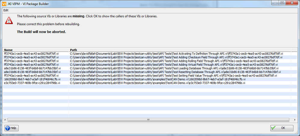

The trouble I'm currently having is with VIPM, which is failing to package my application so I can hand it to a colleague. When trying to build the package, the build will abort with the message that "source VIs or libraries are missing", referencing a number of VIs with GUID names, apparently located under my actual VIs (i.e. it seems to be treating my actual VIs as folders). See below:
All the files listed are either test or example VIs - this means they share the common property of being "top-level" VIs. That's the only thing I notice about them that they have in common.

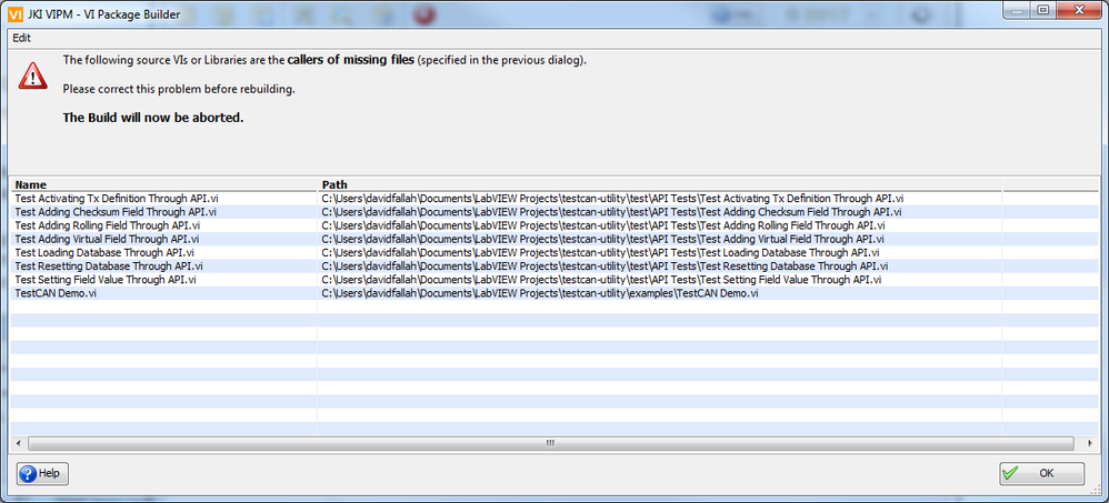

If I click "OK", it brings up the dialog shown below. Here, it lists all of my actual VIs as callers of these missing GUID-based VIs:

See this link.  It’s a VIPM bug (JKI Case 17570) with the new “malleable VIs” or VIMs.  VIs that call VIMs cause this error in VIPM.

Ah, that explains it. Another thing all these failing VIs have in common is that I call "Stall Data Flow.vim" in them. Thank you, marking this is the solution.
