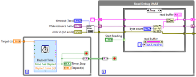

Goal: Launch a .vi that starts reading from COM port X for 5 seconds and automatically stop, save the read data to a text file
Hardware: generic UART to USB serial converter
Software: Win10 + LabView 2017 + TestStand 2017
Additional Info:
COM port X is an debug UART that spits out information regarding a device. Some commands are sent to device through COM port Y, but results are shown in COM port X.
The flow of data being read from this COM port X is not constant. Data might not show up for 30 seconds at a time.
What I achieved so far:
Flush buffer of COM port X is done prior to opening the Debug_UART_Results.vi
I can start the reading, and after the loop ends, the data is stored in the text file as intended.
The issue:
The timer counts down only while actual data is read from COM Port X.
If data isn't read at any point, the timer pauses and waits infinitely for new data, therefore the loop does not stop.
If COM port is not active \ connected, the elapsed time boolean successfully stops the loop and the .vi closes as intended.
Work around - not acceptable:
To send additional dummy commands on COM port Y to keep data coming to COM port X so that the elapsed time closes the loop.
Alternative solution: I tried with two separate loops connected via channel writer - reader, but I just cannot make the Read debug UART loop to stop.
I'm sure the solution is simple and staring me in the face, but I just can't see it.
Any hints would be really appreciated.
Best Regards,
John

Comments on your VI:
Please use AutoCleanup to ensure basic style guidelines like "wires from left to right"…
You initialize the VISA connection to use the default timeout: VISARead might wait for 10s until it gives a timeout error in case no data arrived…
You don't seem to handle timeout errors at all!?
What's the point of this 10ms wait in the Read case? This wait belongs into the FALSE case!
I recommend to use a shift register, tied to the outer loop, to store the "read buffer" data (instead of the feedback node inside the case).

The ElapsedTime will only update, when the loop is iterating: this is basic THINK DATAFLOW!
The loop can only iterate when the code within is finished: this is basic THINK DATAFLOW!
The code can only finish when VISARead finished (on Timeout, data read or TermChar): when no data is received it will wait for (default) 10s timeout!
I don't think your loop (aka timer) "pauses and waits infinitely"…

what's the point of that channel wire and separate loop?
@pinkman_john wrote:
I can't use the ThermChar, as I might get multiple messages depending on the command.
Then you should disable the TermChar - you did not so far…
Btw. there is a VISA property node for "TimeOut" so you can change it at any time.
Do you really need this "default if unwired" tunnel in the case structure?

Hi GerdW,
The separate loop is just to display the "timer" and elapsed time boolean in real time on the front panel (it's visible during the test in debug mode so I can see the response in real time).
Also being new to Labview, I am trying different techniques to get familiar with them.
Yes, I should disable the ThermChar. Thanks!
I have it as a controll and it can be adjusted from TestStand for any particular case.
You mean for the string in "False" case? I guess not. I connected the in and out directly.
