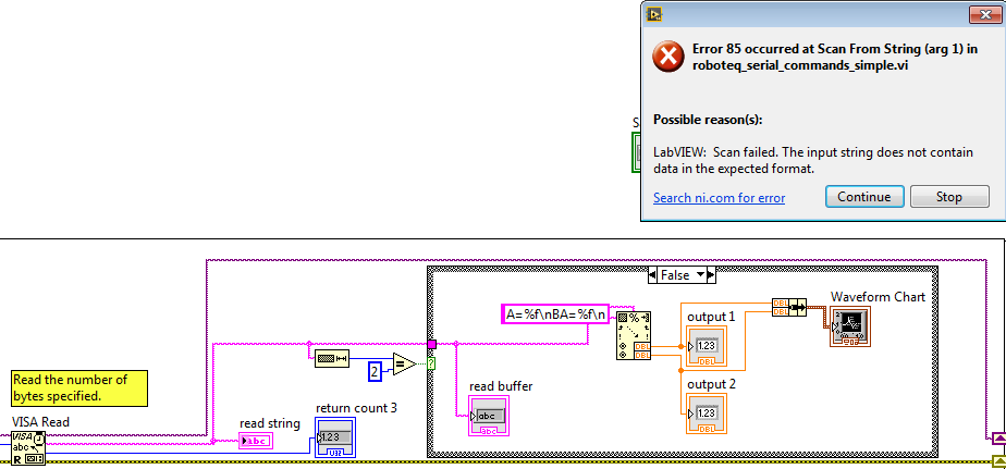

Please show your read buffer in hex display…
Message 12 of 16
(953 Views)
Here it is :
Message 13 of 16
(945 Views)
Hi Trainee,
your values are separated by a CR (0x0D), not by LF (0x0A).
Change your scan string accordingly!
Message 14 of 16
(943 Views)
Thanks again. How can I know if it is separated by CR or LF?
Message 15 of 16
(940 Views)
Hi Trainee,
The first place to look at is the manual of your device. There you should find all the details of data communication…
If that fails you can look at the received data - as I did. Then compare the (hex) data with an ASCII table of your choice!
