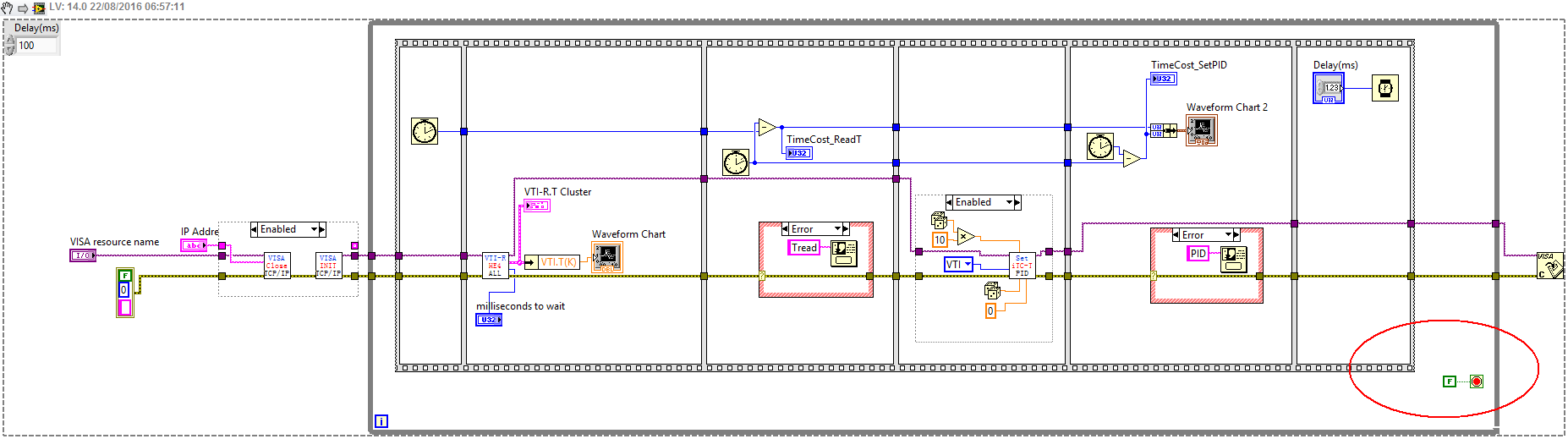

Attached please find the VIs. Thanks.

Not commenting (yet) on other possible problems with your VI, first please fix up the stopping mechanism of your VI! What you use now is totally silly: You set the while loop to run forever, and I guess you use the red "Abort Execution" button on the VI's toolbar at the top to stop your VI. This is not good. In this way your code (VISA Close function) outside of your while loop will not run at all, since you just abort the execution. Therefore, your VISA resources are not freed! Delete that False boolean connected to the stop condition of the While loop, and put a Stop button there. Do NOT use the red Abort button any more!

Yes, that is a silly mistake. I have corrected this with a boolean control button. Now it seems OK with Run/Stop.

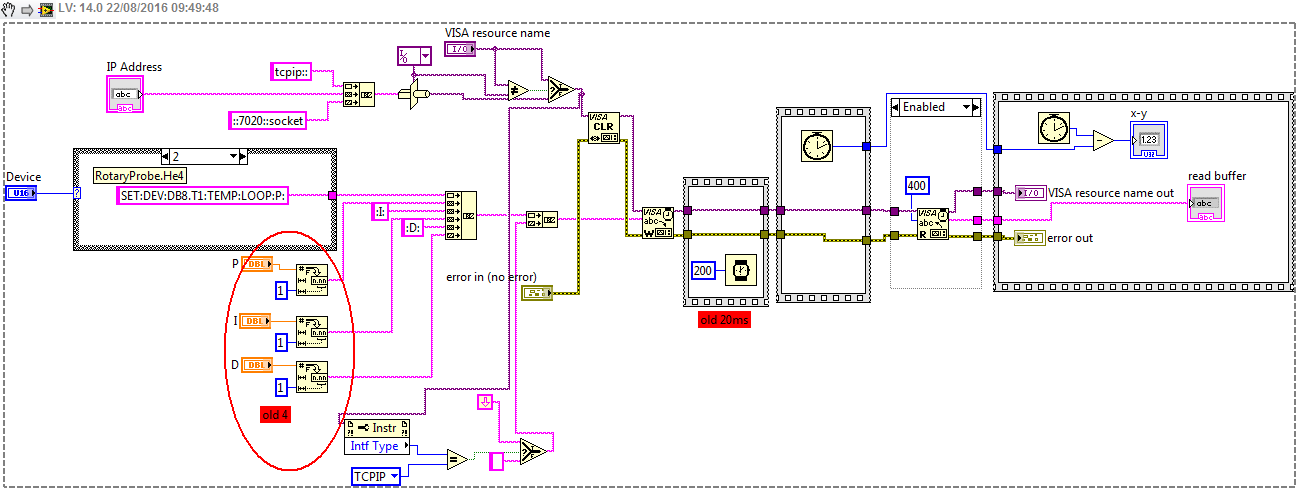

Well, you should report errors in your VI, or at least put an error indicator somewhere. When error happens, you can see the description and the source of it. Maybe you try to set "too fast" the device? As I see you also started to modify the driver VIs? This is not related to your timeout error problem, but for example why you limit the precision for the PID parameters to 1 digit after the dot (see the snippet below)? I also do not understand what you try to do with this VI, why you repeateadly change the P and I parameters using random numbers??? If you have a PID control, you should tune the system, and usually you use fixed PID parameters. Do you know what you are doing?

I wrote all the subVIs myself. ( In the beginning, I used 4 digits fot PID parameters. Because of the frequent timeout errors, I limit the precision to 1 digit to see whether the digits caused this toruble.  )

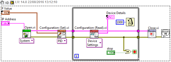

And, what is the problem using the driver VI? If you use the driver properly, it should not take more execution time than your "home made" code I feel... Besides I repeat, setting the PID parameters in a while loop is just silly, no idea why it is a way for timeout error testing? You are not supposed to change PID parameters with the same rate as data readings... If you need to change parameters during runtime, you should use a State Machine to separate different configuration steps from the pure data acquisition code part...
What kind of parameters do you need to read? What is the required sampling frequency? Could you test the following VI (does it give you all parameters)?
