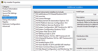

When you build the installer (after you build the application) you can select something like "include required runtime components" which should include everything you need.

Answers here.

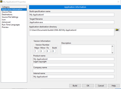

Thank you. My problem is that I do not have "Additional installers" heading in the Category toolbar.
