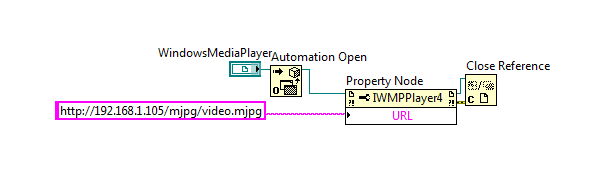

I know there are a couple of posts already about this but I can't seem to open the other Vis that have solved this issue.  I am running labview 9.01 and I am trying to use VLC to play a webcam from an IP address.  I have it set up right now using WMP but it doesn't work cause WMP is terrible.  Is there a way I can do this with VLC?
I can see when I use activeX i can insert VLC activeX PLugin and IE web plugin v1 or VLC activeX PLugin and IE web plugin v2 but LAbview crashes when i select that.  Is there a different way?
