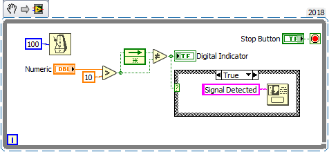

Hi hossaimm,
your "solution" should be simplified to this snippet:
No event structure needed! (And you don't need to create events on indicators…)
I need to implement this in 2 while loop not in a loop.
So you failed your own homework description?
Using two loops absolutely makes sense here as your current "solution" stops signal aquisition as long as the dialog box is shown. You should implement a (proper) producer-consumer scheme using queues (or user-defined events)…

@hossaimm wrote:
I just want to have the calculation/decision(as attached pic) done on my right loop.
The comparison is already made in the right loop. Nothing to change. Can you explain what you really want?
Here's a simple rewrite. See if it works for you. I repeat: event structure are for controls, not indicator!

@hossaimm wrote:
Normally event structures are for controls. However, I need this for indicators.
Obviously, you still don't get it! Simply place the file writing code inside my case structure! Abusing event structure for indicators is rarely never a good idea. Please study my earlier code.
Also note that your boolean logic is flawed because e.g. if alarm A is on and alarm B goes off, you won't notice a change. Your conditions needs to be labeled "all alarms off", "any alarms ON".
You still don't have a wait in the right loop. I doubt you can change the controls millions of times per second!
