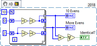

P.S. -- A shift register that does not have something wired into it from outside the loop (on the left) is called an uninitialized Shift.  The "rule" for these is that they "initialize" themselves by taking the "default value" for the particular data type they contain.  Single-loop Shift Registers ("Memories", such as you've coded), generally get "initialized" the first time they are called, when a value gets put into the output Shift Register for the first time.  But you can initialize it yourself -- here's how to create an Array consisting of the first 10 Even Numbers.  I did it twice, once initializing the Shift Register to 0 and taking the values after I incremented it twice, the other initializing another Shift Register to 2 and taking the values before I incremented.  The code at the exit compares the two arrays and asks (using the upside-down A, logic for a Universal Quatifier, i.e. "Is Every?") if all the elements are the same.  If you run this, you should get the Indicator to light up.
Shift RegistersShift Registers
For Extra Credit, will anything change if you delete the I32 constant 0 initializing the first Shift Register?  [Try it].
