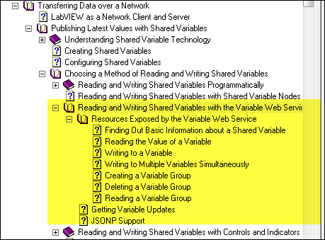

You can find documentation about the Variable Web Service in the LabVIEW Help, available in LabVIEW by selecting Help»LabVIEW Help, in the following help topics (or search the Index tab of the LabVIEW Help for "variable web service"):
You can print all related topics by right-clicking the Reading and Writing Shared Variable with the Variable Web Service topic and selecting Print.
(5,988 Views)
Oops .. many thanks! I missed that section in LabView Help. This is exactly what I need.
