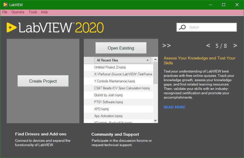

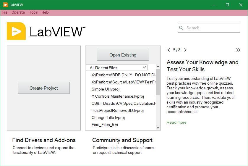

But it doesn't seem to follow the version. On some systems it's black/gold, on others it's white/orange; regardless of version.  Both those screenshots are of LV2020, just on different computers.

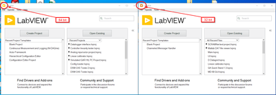

Black/gold is 20.0f1 (32-bit).  White/orange is 20.0.1 (32-bit)
Message 8 of 11
(4,926 Views)
Here is how 20.0.1 looks on my machine with default window appearances:
Notice the icons are different in the title bar but not on the splash screen. The icons on the taskbar match the title bar icons.
Yup. The color scheme was changed between LabVIEW 2020 and LabVIEW 2020 SP1.
