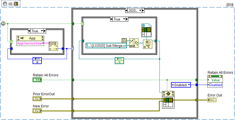

What about a dynamic call ?
It's a bit slower, especially on first call, but that works:
 Also there are considerations when building into an exe or ppl. The "Sub" must be included in builds for versions >= 20.

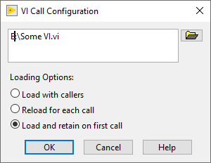

I'm not sure if this works, but you could give it a try.
Instead of opening a VI reference, buffering it and then do a call by reference, you could use the VI, and right click it, Call Setup, select Load and retain on first call.
That should theoretically do the same, but I'm not sure how that will turn out when the DUT is a different version.
If it works, it will save a bunch of code.
