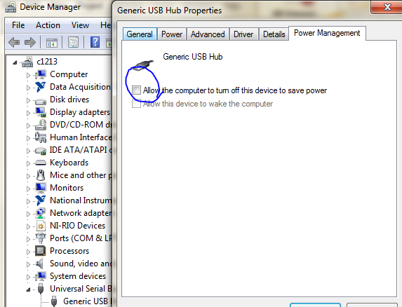

That serial COM port is actually a USB Virtual COM port and you have not changed the default power management options on the USB Hub.
(You wouldn't be the first to miss that setting)

It will appear in both the comm port and the USB sections in the device manager. You need to change the power settings on teh USB entry.

It will most likely appear as a generic USB host. Look at your device manager with the USB to serial converter plugged in and then look at it after you plug it in. You should see a new entry.

Its a right click>> propertys on the USB hub enteries then the you'll find the pm option tab

Hello to everyone,
I changed the settings of all the usb entries but the problem still occurs.

Accepted by topic author Keksbold
Ok it looks like time to copy this FAQ entry: (posted in a not yet public location~~~ Hey Jordan? is FAQ's still on track?)
In this topic we will discuss some of the common problems that have been observed using USB devices with LabVIEW on Windows operating systems.  Many of these points are also applicable to other environments but the examples will be use the Windows 7 OS.
FAQ 1 : My USB device stops working unexpectedly.
The first thing to look at is the OS power saving options.  There is a global trend towards developing "Green" electronics and energy star ratings are getting fairly common.  "If its not being used shut it off" is nothing new.  Cavemen learned how to bank a fire to preserve energy that would otherwise be wasted.  Likewise, the Windows OS has a power saving feature to shut down power to the USB hubs when no user activity is present.  In Automated systems this feature can cause problems since removing USB hub power will shut down the USB device.   Solution: Use the device manager to change the USB hub Power Options.
FAQ2: I set the power options and my device connection is still unreliable: Remember, those computer USB ports are often the cheapest that can be mounted on the chassis and share the PC system power supply to supply USB Power. Most uses of USB are temporary connections like a thumb drive or a camera.  These connections do not require high reliability since the user is right there interacting with it.  Power surges and fault tolerance at worst cause the operator to retry the data transfer.  Automated systems require a bit more robustness.  Solutions:
1) ALWAYS use an external self powered hub.  Perform your engineering due diligence and inspect the devices specifications too- If you can't find them for that device that should clue you to seek an product from a vendor that WILL publish their specs.
2) High noise environments require the use of ferrites on the USB cable- and don't buy the cheapest cable either! The cheap ones are poorly shielded.
3) PROTECT the HUB connections-  If you have a USB2.0 device and Joe User plugs in a 1.0 device in a open slot managed by the same hub- Bingo every port on the hub may back convert to USB1.0.  WORSE there are a lot of damaged or marginally engineered USB devices out there.  Joe User's device may cause power fluctuations when it is inserted or removed from the hub just don't let it happen!

Hey Jeff,
unfortunately I do not have a self powered USB Hub to test whether it would work then.
However, given your enourmos expertise and happily watching the system run with the normal RS232 port, I assume that your assumption is correct.
Thanks a lot, never would I have guessed that this was indeed a hardware problem.
