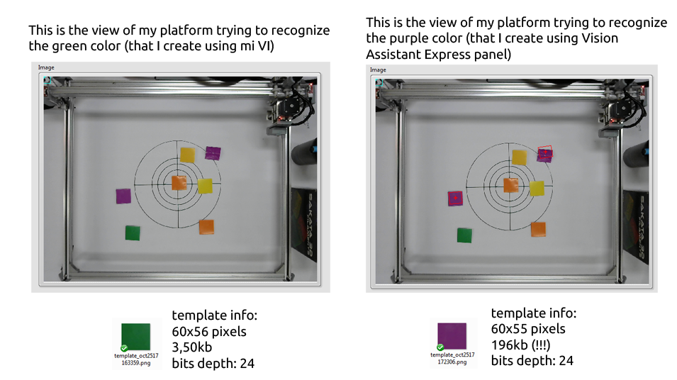

I think I miss an important point of my issue...

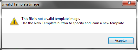

The template that I'm saving I'll use it after to recognize it via webcam using Color Pattern Matching with the Vision Assistant Express, here is when the template doesn't work (even if I open the panel of Vision Assistant Express and load the template there it prompt me that is not a valid template format, but when I create a template there and use it on my VI, the recognition works)
When I try to add the green template (that I took from my VI) in the express panel, this is the message:
I don't know where is the difference between the two pictures to have this problem... I'm even using the "NPG with Vision Info" block to save the image...

So an image of 60 x 56 24-bit pixels is about 1Kb, somewhat smaller than the sizes you mention, but certainly closer to 3Kb than 196Kb.

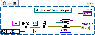

Too bad you are using the "Information-obscuring" Express VIs instead of working directly with IMAQ and IMAQdx, where we could more clearly see what you are doing.
For example, this code writes a 60 x 56 32-bit RGB image (here called Template.png) and, with the default PNG compression, the file is 236 bytes.
