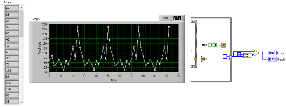

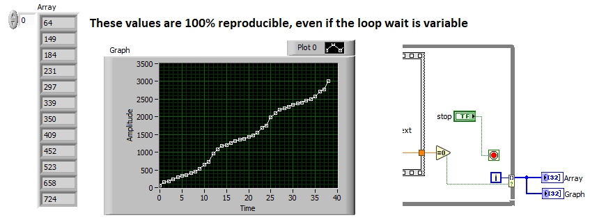

Curiously, [i] is always 64 when the stop occurs. Might be a hint. 😄 In fact all iterations where the zero occurs is always at the same iterations: 64, 149, 184, 231, ...). Tried no wait, 1ms or 5ms wait.
Maybe some numerologist can see a pattern 😄

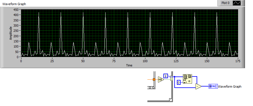

And here's a picture if the delta(i) between zeroes. Looks like an EKG. Fully repetitive:o
OK, this is very confusing, because it seems to depend on other factors. While the values seem to be always the same on the same computer, the result are quite different on another machine:
AMD Ryzen 1700x: 64, 149, 184, 231, etc....
Dual Xeon: 158, 189, 213, 169, 282, etc....

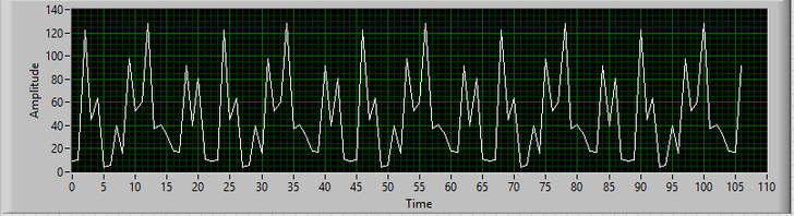

This makes no sense. I wonder if the values change after a reboot, for example. Here's the xeon pairwise difference. Note that the period is now 18 samples long. (was 13 on the AMD)
I wonder what others are getting... 😮
