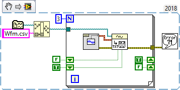

You don't (quite) have the right idea about the Waveform to Spreadsheet File VIs, particularly the Boolean inputs.  When File I/O doesn't work quite right, it's often a good idea to use the "Engineering Workbench" part of LabVIEW's name to build a small test situation and explore it, say, a For Loop looping three times, generating a Waveform and writing it to a Spreadsheet File.  Remember how to use Shift Registers -- ideal for something you want to be True (or False) the first time, and "the other way" the rest of the times.  Like this:

I agree with with you. Actually, I tried to find some examples that could show me how to use the Waveform and writing it to a Spreadsheet File, but I did not get find the good ones, I am beginner yet.
Thank you for your great advice to use the "Engineering Workbench". I will test it now.

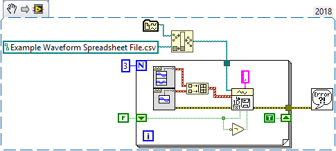

Unfortunately, you didn't completely understand the Write Waveforms to File example.  It was showing you two ways to write Waveform Files, as a Binary file (.dat) and as a Comma-delimited Spreadsheet File (which the exampled called .txt, but which should more properly be called .csv, especially if you change the delimiter from its default <tab> value to a comma).
Here's closer to what you want to do:
I'm building my multi-channel Waveform from two Waveform Generators, am using the .csv extension, and am using Comma as a separator.  I've never used the Waveform-to-Delimited Spreadsheet function before, but it has a bug that I will report to NI, namely it adds a blank space after the second, third, ... append (but not after the first, curiously).
See if this is closer to what you want to do.

Bob,
It still doing the same thing, even that I change from txt to csv. The issue is not acquire multichannel datas and separate the channels by column.
The issue is that I need to separate the datas by each execution the loop for adding a new column. Example, if per each execution the loop for generates 1000 lines of datas, when the loop for execute again the program will need add the new data creating new column with 1000 lines, what create a matrix of 1000 lines fixed with number of columns with the same number of execution of the loop for.
I did it with the last code I sent previously, I will send again with some modifications. If you look the file generated you will see that it will have many columns with the same number of the execution the loop for, but the columns will have the same data, when it should be different each other.
I attached another VI (SaveFile.vi) , I got the solution, but it is not the best.
