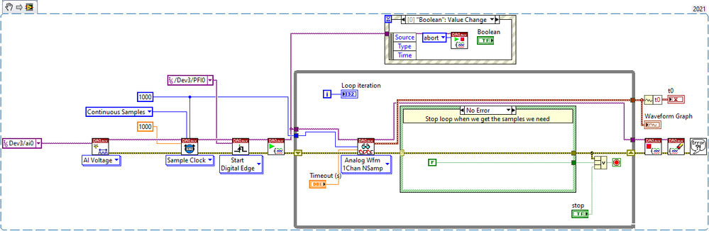

Hi Kevin, thanks for the reply! I am using Windows 10 and I am indeed in US central time zone. I think you might be onto something regarding the Unix epoch time. I am attaching a VI here that will recreate the behavior I am describing. Since the simulated daq devices auto trigger themselves, I think it will require someone with some physical hardware to fully recreate the scenario. Using the attached code, if you set the timeout to 30 seconds and send a trigger pulse over PFI0 during that window, the code will return 1000 samples with t0 set correctly. If instead, you set the timeout to something small like 0.1 seconds, the code will still return the expected samples upon getting a trigger pulse on PFI0, but the t0 of the waveform will be 1969.
Also, I saved this for LabVIEW 2020, but I am using LabView 2022 Q3 with DAQmx 22.5.

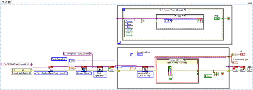

A "task wire" is like a reference/queue wire, you can branch it and use the Abort Task if you are in in a "infinite wait mode", that is, timeout set to -1. Use a button to initiate it. See below. (There is probably a better way but need hardware to test it. This will work for any task, used continuous acquisition to show you can stop task outside the loop. You will have to catch the error though.)

This solution seems to work, thank you! I am attaching a version of this that works on my real hardware in case anyone in the future should want to reference it. Essentially it ignores the aborted task error and has some logic included in stopping the event structure loop to determine if the task needs to be aborted or not.
