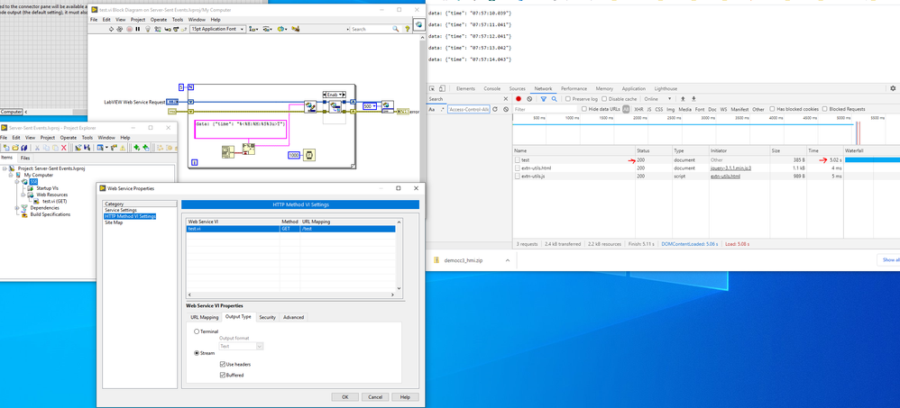

I put together a quick test (attached in zip file) to try to stream output messages at 1Hz for 5 seconds, but Chrome doesn't see any data until the entire operation completes.
You can see I have it configured to Stream, and I am actually flushing the buffer after every message, but as shown in the Chrome inspector view, nothing shows up until a full 5 seconds have passed.
Also: it throws a warning when I try to set the status code after performing a flush. As you can see in the screenshot, I attempted to set the code to 500, but according to Chrome, it actually received 200. (And, again, the flush doesn't appear to be working for me, anyway...although I swear I did see it work once before).
I have also tried disabling buffering in the web service properties, but that doesn't appear to have any effect.
Can anybody see what I am missing here?

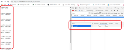

I believe you have to set the correct "Content-Type" header value to "text/event-stream" for this to be recognized as an EventStream
I recreated your project (still at LV2018) and tweaked the code a bit so that it should work.
This example should be correctly identified by Chrome as an EventStream:
(not sure why the individual events don't show in the list tho, I know this used to work)
I doubt if you can push a different status code though since you already acknowledged the request with the 200 status code.
