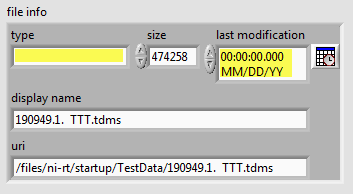

Regardless of whether I use WebDAV Synchronous or Asynchronous VIs to retreive a directory list, the file info's cluster type and last modification elements are empty.  The RT has WebDAV Server 13.5.0 installed.
I did notice that the type is populated for text files (text/plain), but last modified is still empty.
I'm guessing the MIME type of TDMS files doesn't exist?  I don't require that information for sorting.
However, the last modified information is very important for my applications & users for sorting the file list.

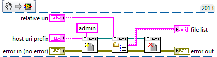

Here's the WebDAV section of my code.
Thanks for any suggestions.

The issue has been assigned to CAR 513004
The problem details...
  • WebDAV Server 13.5.0 & 14.0
  • RT Targets with VxWorks
  • The NI_WebDAV.lvlib, Directory Listing.vi does not return last modification values in the FileInfo.ctl array.
