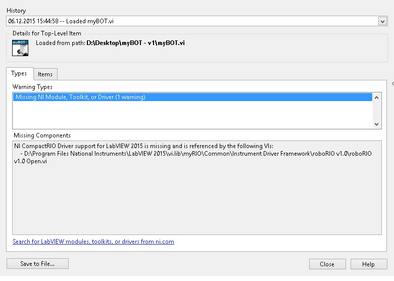

So its more likely a module problem maybe?
I have now connected the motoboard H bridge / two motors  and the gyro board.
The first message is not longer I2C therefore I was thinking that problem was solved and it had to be the gyro as you suspected.
The fault message i get is identicall to the first post i added to this forum tread.

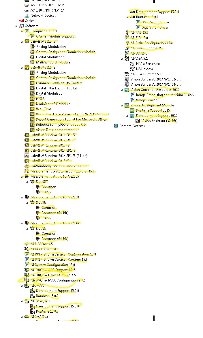

Anyone here that has the 2015 version myrio ?
That is able to open this project https://decibel.ni.com/content/docs/DOC-34547  myBOT-V1.zip(3.7 MB)  without any fault message of missing toolkits, driver?
If so it would be great if you could post a picture of MAX that shows all installed drivers and toolkits.

Where did you installet it?
It seems like you installed LabVIEW on you D drive?
It could also be that the RoboRIO vi that is listed, has a worng link to find the right module?
Have you tried to open the vi in the picture and save it?

Update!
The erro code is gone after installing 2013 version.
Added a picture here of what software/ drivers that has been installed.
Thanks for all replys.
