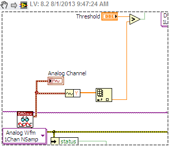

What is the purpose of the Index Array Function in attached example?
I am struggling with the Index Array Function. I found the attached VI on the NI site which ws exactly what I wanted to do, but rather than just accept that it works and use it, I wanted to understand it.
What is the purpose of the Array Index Function inside the While loop? If I put a probe either side of it, the values are identical, yet if I remove the function and connect directly to the > function, I get errors.
I do understand arrays but I just don't get what is happening here. Any help would be gratefully appreciated.

It's just picking the first reading from the array in the waveform.  If this is good enough (I'd at least take the mean of the N Samples), why not this?

that was the filename on the NI site. I've renamed it now. I've also attached an image of the block diagram so that the VI doesn't need to be opened. So any help on what the Index Array Function is doing would be great thanks.

Hi Jim,
I've looked at your reply and most importantly I understand it. Thanks for finding the time to answer this for me.
