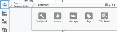

I would recommend installing the LabVIEW SystemLink Toolkit.  It should include support for LabVIEW 2017-2020 and NXG 5.0.
https://www.ni.com/en-us/support/downloads/software-products/download.labview-systemlink-toolkit.htm...
