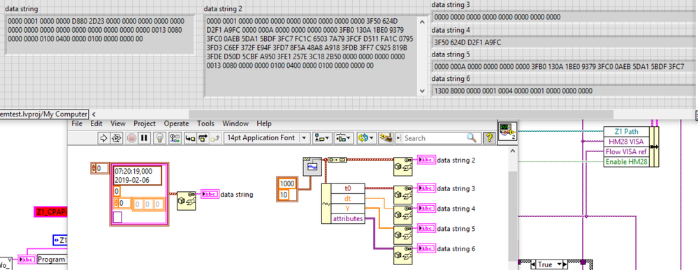

As Altenbach mentioned, Write waveform end up in a Write Datalog, which is a raw binary of the waveform. So if you play around with Waveforms and Flatten to string it should become apparent. It writes an away of waveforms, and looking at it:
[array size, 4 bytes (int)]
[datetime 16 bytes]
[dT 8 bytes]
[data array size 4 bytes]
[data array, x doubles of 8 bytes]
[filler? 1 byte ]
[Variant, X bytes with attributes, "data string 6" with empty variant]
Waveform binary formatWaveform binary format

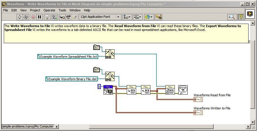

There is an example, where "Write Waveforms to File" is  used in NI Example Finder. According to that VI the extension of file is .dat. Write to waveform.JPG
