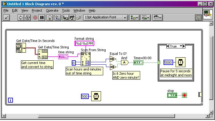

In 12 hr time there are two 00:00 occurances (midnight and noon).  Is this what you're asking for?:
EDIT:  Oops, obviously you need to change that so it compares the hour to 12, not 0 (zero).

@NIquist wrote:
In 12 hr time there are two 00:00 occurrences (midnight and noon).  Is this what you're asking for?:
I doubt that.  The way he wrote it, it sounds like he wants military time.  Midnight is 0000.  Noon is 1200 hours.
In normal time, there is no 00:00.  Midnight is 12:00am.  Noon is 12:00pm.
