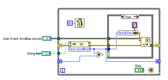

One solution would be to create your own user event at the initialisation of you main and launch a thread which is going to be pulling the value of your scrollbar position:Scrollbar event.PNG
Then you can build your main as if they were a scrollbar move event.
And dont forget to close the thread and destroy the event at the end.
Hope it helps.
