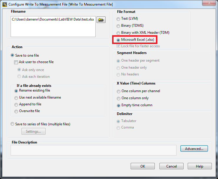

Another option if you don't want to have Excel installed is the Write To Measurement File Express VI:
This doesn't allow you to customize the file by creating new worksheets, etc., but it is a really quick way to get LabVIEW data into an Excel file without having Excel installed.

Of course, if you use the Write to Measurement File Express VI to create a file with the .xlsx extension on a PC that doesn't have Excel, you might wonder what you are going to do with that file -- you can't use Excel to process it (the PC doesn't have Excel, remember?), and I'm assuming that if it really is an Excel-specific file (as suggested by the .xlsx extension), then even LabVIEW won't be able to read it back.
