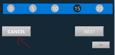

The user has to answer the 6 questions and the 3 radio buttons comparisons. He clicks on the next button to go to the next step.
What I can't do: when the save button is clicked, I want to return to the Show Item1 (question 1) state, as shown in the image below.
How do I do this?
There is no "save button" in your image…

HI GerdW,
It's normal that the save button isn't in my image.
The save button is available in the last question.
the image I sent is the first question. By clicking on the save button, I want to be able to return to question 1.

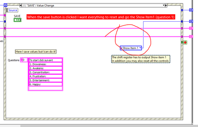

hi
You just need to output the shift register to Show item 1.

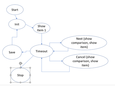

Alternatively you can create another state called "Init" that is executed in the beginning of the program that "reset" all controls to a desired state then goes to "Show item1".
So when click SAVE it will direct to the "Init" state , reset everything and go to "Show Item 1".
The state machine diagram would look something like this
One suggestion: Replace "CANCEL" for "BACK"

I spent too much time trying to understand why/how you wrote such a complex "check the many boxes" hard-coded routine whose real workings I was having a difficult time understanding.  I even tried running it, and couldn't figure out what I was doing and what you were measuring.  But then I looked again at the title, and said "Oh, simply have the Save case put "Show Item1" back on the Shift Register, but LVNinja beat me to it.  Kudos to the Ninja!

Hi LVNinja,
thank you for your reply. Yes indeed it was easy, thank you very much for your answer, your explanations and suggestion...
It works as I wanted now.
