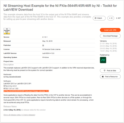

Hi
This VIPM description may guide the search direction for the IDL :
Maybe somebody knows where the highlighted software can be found. It was not part of any normal distribution I know of. Maybe it was delivered with the hardware on a CD those many years ago.
Regards
