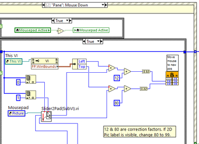

This is a small project to simulate a touch pad. Basically everything is working. The sliders can be moved with the cursor keys or mouse. Clicking the scroll wheel will activate the touch pad and move the mouse to the position equivalent to the last values of the sliders.
I have zipped the whole project for testing.
My question: In the "Pane": Mouse Down, True case (larger one), there are two contants: 12 and 80. I cannot see why these are required to position the mouse correctly. The values do not seem to correspond to a border height or anything. Maybe someone could have a look and find the reason.

According to the comment in the block diagram those constants are related to the position of the 2D Picture control/indicator labelled "Mousepad"…

Wow, that was quick! Try setting the constants to 0 and see where the mose goes. It moves the cursor to a different position and adjusts the sliders accordingly.

You need to handle differences between LabVIEW screen positions and Windows mouse position.
Atleast it seems to be a fixed offset as for me (virtual machine, Win10, taskbar moved to left side of the screen) your VI works with the same values…

The position of the front panel is taken into account. As is the position of the 2D picture on the panel.
All I have done is to calculate the coordinates in the picture based on the sliders using y=mx+c.
Effectively, the X-axis goes from 500 to 2500 which equates to the picture left and width. Same with the Y-axis. This is detailed in the video here

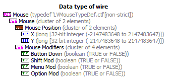

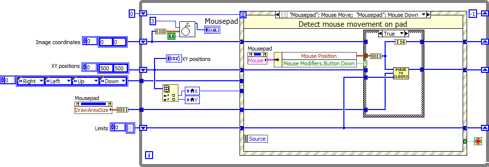

The correct way to get mouse coordinates of a picture is with the mouse property. No need for any tweaks:
All that remains is the scaling between pad size and slider range.
The event should be mousepad...mouse down. Typically you don't care about mouse coordinates outside the picture (i.e. "pane"). This will greatly simplify your code!
(On a side note, it would be great to have that cluster as an event data node. Could be an idea....)

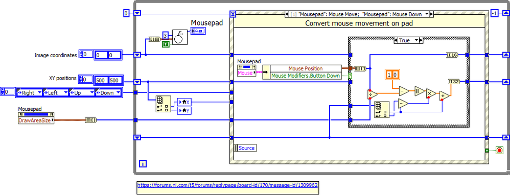

See if this can give you some general ideas...
(Note: I uploaded a new VI recently, so make sure you have the correct one)
Message 9 of 14
(1,535 Views)
Accepted by vtiu
Quick cleanup using subVIs for scale conversion between image and sliders.
