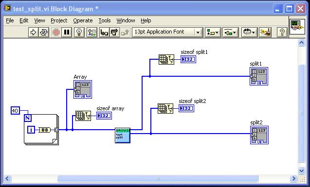

Here is a screenshot:
split_dll_vi
sizeof array = 40
sizeof split1 = 38
sizeof split2 = 42

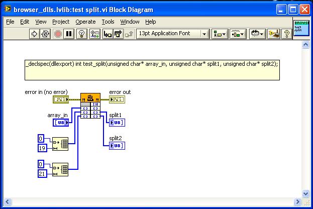

Can you post the DLL calling convention with the parameters list?

Calling convention:
and Sub VI:

Well, I think the fact that in the configuration for the DLL you set the minimum size of split1 to be 38 and the minimum size of split2 to be 42 might be a clue as to why your arrays are... 38 and 42.
If you read the documentation on that setting it says:
Indicates the minimum size of a 1D array and allocates the correct amount of memory. You can enter a numeric value, or, if you configure an integer parameter in the Parameters list, you can select the parameter from the pull-down menu. The default is none. This option is available only for array data pointers. If you pass in an array that is smaller than the minimum size, LabVIEW enlarges the size of the array to the minimum. If you pass in an array that is bigger than the minimum, the array retains the larger size.
