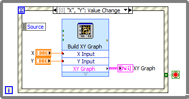

Why doesn't a line plot here instead of just a single point?
See if this works for you. Modify as needed.

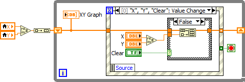

(Still, it might be easier to build the data in shift register as a 1D complex array. This way you can add more functionality, such as a button for clearing the data, etc.)
Message 11 of 13
(501 Views)
Accepted by Tinsnips
Here's how that could look like. It is typically better to avoid express VIs. 😉
