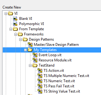

New... opens this (I actually keep them on a pallate under favorites too with Place Contents enabled) 1 click to place this including documantation
