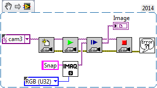

OK, now my lights are on (in more ways than one!).  I opened MAX, noted that my Logitech C920 is called "cam3" by MAX, and made sure that a Snap worked.  I then laid down a few IMAQdx functions, shown below:
The first was Open Camera, to which I wired a Constant to the Session In input, then chose "cam3" from the Drop-down choices.  Next came Start Acquisition, Snap, and Stop Acquisition.  Snap needs an Image input which I create with the IMAQ Create function, naming it Snap and saying that it is 32-bit RGB.  On my Front Panel, I place an IMAQ Image Indicator, to which I wire the Snap Image Out.
When I run this, a picture appears of the top of my head (fortunately my whole face isn't visible, preventing my computer from crashing).
If you need to make videos, there are a few more hoops through which to jump, but it is largely a similar process.

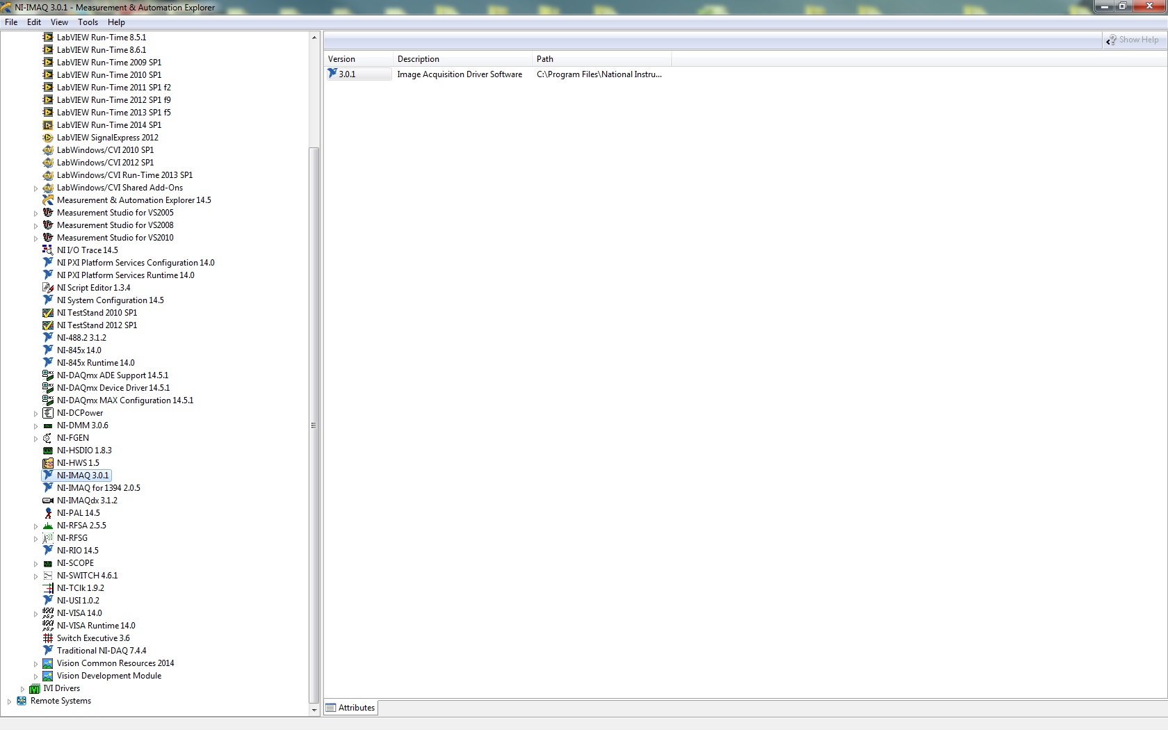

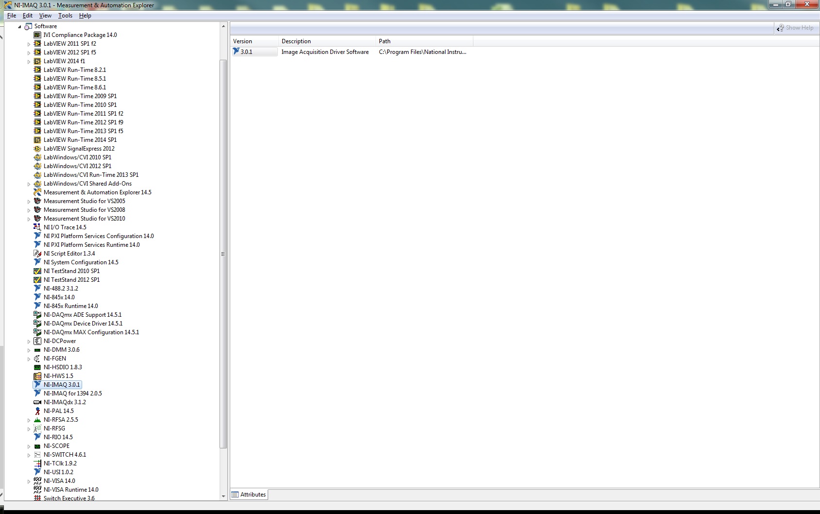

Hi Randy,
Here are a couple of screen shots of the NI software that I have loaded on my PC.
