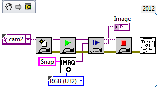

Mark,
     Did you try the tiny program that I submitted?  It is a Snippet, which means you should be able to open LabVIEW 2014, create a New VI, open its block diagram, then drag the image from your browser to the Block Diagram where it will become LabVIEW code.  Click on the Camera Constant and choose the name of your camera, then run it.  What happens?  Do you get a picture?  If not, what does happen?  Errors?  It "gets stuck"?  You are trying to do "something else"?
Bob Schor
Message 22 of 31
(2,474 Views)
Hi Bob,
Thanks for your reply. My latest version of Labview is 2012. When you say browser, what exactly do you mean? The only places that the camera appears in is in the windows device manager and in the Logitech app that came with the camera.
Message 23 of 31
(2,461 Views)
Mark,
     My apologies for (a) not realizing you were using LabVIEW 2012, and (b) not being clear about Snippets.  The image shown here is a LabVIEW 2012 Snippet, a file with a .PNG extension (so it "displays" like an image) when you view it in a web browser while viewing the Forums (that's what I meant by a Browser), but has the remarkable property that if you have your browser open viewing the Forums and have LabVIEW 2012 open with a blank VI's Block Diagram open, you can "drag" the image below from the Forums and drop it into your Block Diagram where (thanks to some NI Magic) it will become executable LabVIEW code!  So all you need to do is to go change the (now "cam2") constant to whatever MAX has assigned your Logitech C920, hit the Run button, and the Front Panel should have a picture showing.
     By the way, you can tell this is a Snippet by the NI symbols in the upper left, and the LabVIEW Version in the upper right.
     However, there's a small caveat.  I did this earlier from work where I have a C920 and was running LabVIEW 2014.  I'm currently home, where I have a Microsoft LifeCam that I tried to use with LabVIEW 2012.  I hadn't used the camera in a few years, and wouldn't you know, it wasn't working with MAX, its own software, or LabVIEW.  So I opened a "spare" Logitech C920, which MAX immediately found, but LabVIEW could not!  Sound familiar?
     I think I "fixed" the problem (at least it is now working) by downloading the drivers from Logitech.  In any case, this code now works for me here at home, as well as at work.  Give it a try and let us know if (a) it works, (b) it fails and produces no errors, (c) it fails with errors (tell us the error message), or (d) None of the Above.

Thanks Bob for taking the time to explain it all. I'll give it a try - assuming I can get the camera to appear in MAX.
Mark
