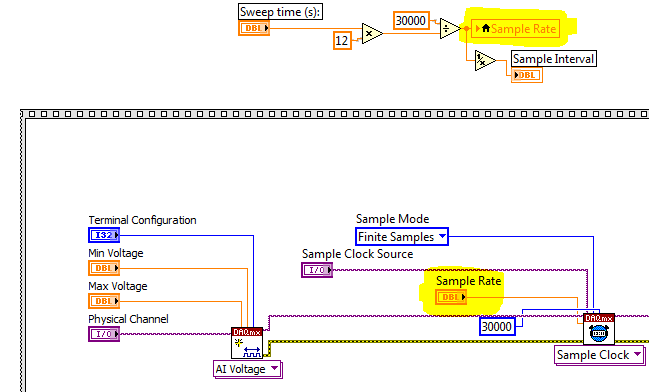

I've written a program to measure 30,000 points of voltage data over a specified amount of time (Called "sweep time"). When the sweep time is set to <=8.33 seconds, the program works without any difficulty. However, when sweep time is set to >=8.34 seconds, only half of the required data, 15,000 points, is taken. This sweep time corresponds to about 300 pps, so I thought it might have something to do with my hardware, but when I rewrote the program with a virtual voltage channel the same thing is happened. What could possibly be causing this?

You have a big, ugly race condition in your code which can explain your issue:
Get rid of it!
There is no need for "Sample Rate" as control in your setup!
