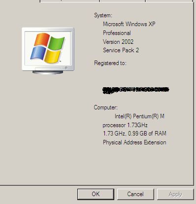

one more question, would u mind telling me the specification of ur computer??
Message 9 of 14
(4,020 Views)
here it is :
Maybe the details of the hard drive have to be concidered... who knows...
