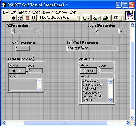

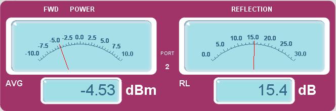

I have a problem... Now When I use Virtual NRT.exe I have good measurement. I have done PRESET, after ZEROING and I have choosed in the Reflection Panel PWR and... it's OK.
Now I have a Problem!!! WHen I use LabVIEW to control the Power Meter I have many Problem!!! See the Figure:
1) I have done SELFTEST and compare:
I don't understand what type of error is showed.

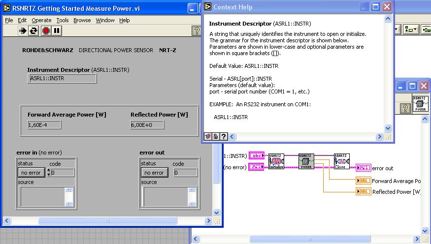

2) When I use Getting Started Measurement I have a Problem. The Power INcident is OK (there is a little error and It's strange that the Power is a little higher that Power that I choose on the panel). BUT THE PROBLEM IS POWER REFLECTED... IT'S IS VERY HIGHER AND I PUT A LOAD THAT ABSORBED ALL POWER!!! I don't Understand very well what is the problem. First of all: the power reflected that I read is the power reflected or other? Maybe I do a similar error that i did when i used Virtual NRT.exe because i read not Power, but other.
 3) Why when I off the Signal Generator and use only Power Meter I have a little Power Incident, but not zero Power like I expect?

Hi vanny,
"Now I have a Problem!!! WHen I use LabVIEW ... I have many Problem!!!" - Funny! :smileyvery-happy:
1) just read what it says: "VISA Read in 'RSNRTZ Write and Read Response.vi'". Use probes and highlighted execution to trace the error.
2) We cannot guess what your VIs are reading from the device, especially when there are reading errors before...
3) We don't know what's happening in your lab...

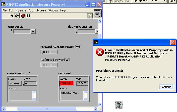

Problem: When I use a VI RSNRTS Apllication Measurement Power that is in Example I have this ERROR:
i DON'T UNDERSTANT WHAT IS THE PROBLEM BECAUSE when I use other VI I don't have this problems.
Do u know why?

Hi vanny,
as I don't have that specific VI, I can't say anything more than the error message...
Oh, wait: There is no device selected in the VISA session control Smiley Wink How should the VI know which device to talk to?
