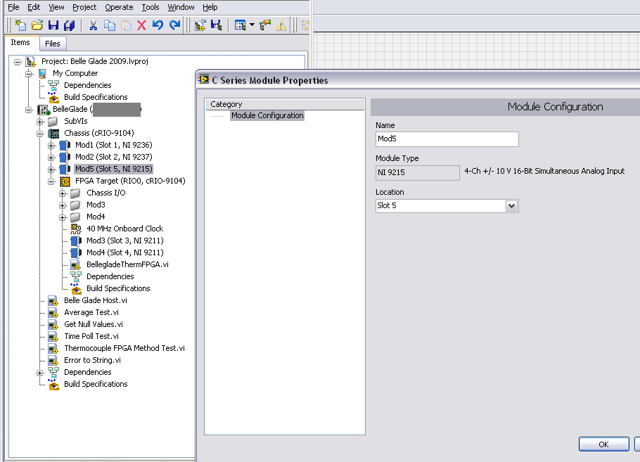

For some reason the scan interface isnt letting me output the raw U32 values. I think it might have something to do with the fact that I am using both scan engine and fpga interfaces in the project, but I am not sure. Any ideas why this is happening?
This is a picture of me right mouse clicking on one of the modules to try to get it to put out raw U32 values like this knowledgebase article says I can.
I put in a service request.. (Reference#7256901) because to be honest I have to know for sure whats going on. I am not one of the engineers/scientists that designed the experiment so I cannot say whether it is ok to chop some of the end of the number off. I would rather simply be able to record all the data in a smaller amount of disk space then go tell them we have to compromise somewhere, whether on sample rate or precision.

I guess I wasn't reading the article carefully enough.
"As of LabVIEW 8.6, there is an option to use the cRIO Scan Engine to interface modules directly to LabVIEW Real-Time by using I/O variables.  In this case, the option to select raw or calibrated is not available in the properties dialog.  When using Scan Mode, all data is automatically returned scaled and calibrated."
Is there any way around this?
