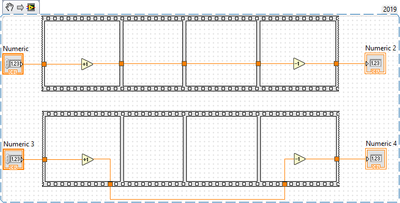

I'm wondering which way to wire data through multiple frames of a Flat Sequence is better. The top option is to just wire frame after frame, the bottom one is to 'exit' the sequence and reenter it later. The code shown is trivially simple, but imagine there are many variables being worked on in that sequence frame by frame, but some of the variables are only used closer to the beginning and then closer to the end of the sequence, as shown.

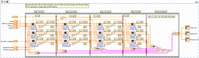

Answering your question, I'm using it in a subvi that executes one step of 4th order Runge Kutta on a set of 3 ODE's, on arrays of values. See the snippet below:
I realize that from dataflow standpoint, I probably don't need the Flat Sequence at all - my question is more conceptual than practical.

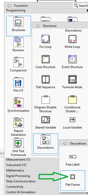

If it is for "organizing code" then why not use
Structures -> Decorations -> Flat Frame

Well, the sequence structure forces LabVIEW to execute in a sub-optimal fashion, so there's a reason behind the advice.  Use the Flat Frame decoration to separate your code visually.
