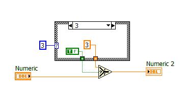

Hi tartan5,
i will show you a trick I sometimes use when I want to update a wire only in one or two among many cases, avoiding all that wiring.
It uses the "Use default if unwired" feature to make sure that the case structure boolean output is true only when my selected cases are hit.
Message Edited by pincpanter on 09-18-2007 05:12 PM
