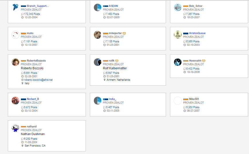

Eventually the remaining %15 of the rational Active Participants may become Proven Zealots.  Go ahead and take a poll on these 12 individuals:
(Branch Support does't get an opinion-  it would take a week and 2500 posts to reach a consensus and is still subject to error)
