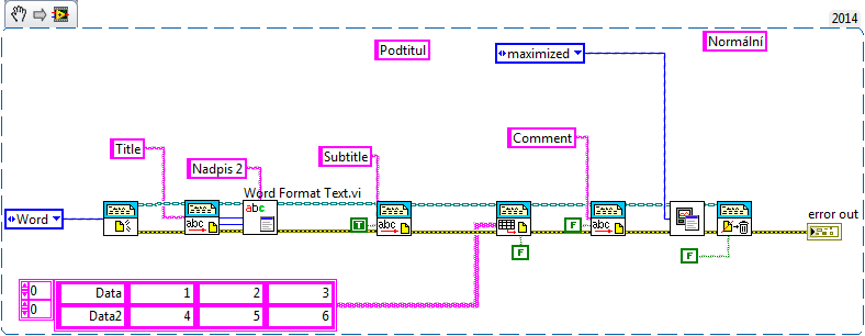

 1. There are added extra lines between each section made by Word Easy Text.vi.
These extra lines are added by the Word Easy Text and Word Easy Table.vi. If you don't want them don't use these vis. Use the Append Report Text and Append Table to Report vis instead as in the following picture. (you will then need to set the style using Word Format Text.vi as I did for the title).
