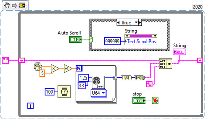

@Alwin_Capsys wrote:
No. Doesn't looks like it works.
This works exactly like you requested:
"When Boolean ON, scroll bar should move automatically.
When Boolean OFF, scroll bar should not move automatically."
 Or not up to my requirement.
Please update your requirement.
EDIT: To be clear. The above code prevents the Text Box from scrolling... not the scroll bar from scrolling. I assume that is what you where after. Seems pointless to have the scroll bar stationary on an ever expanding text box.
