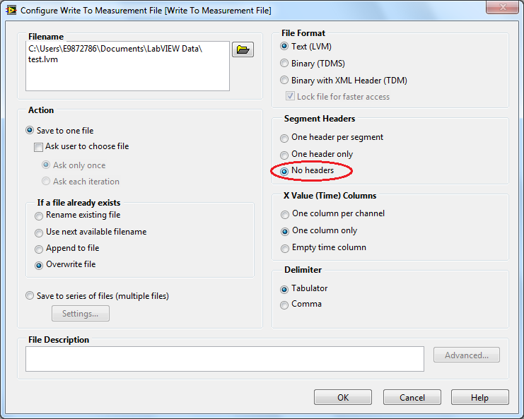

--> To remove the header, you can configure it in Express VI setting as shown below.
No Header
