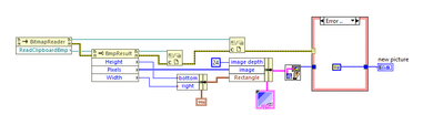

Thanks for Colin's solutions (http://www.colinzhang.net/2013/09/worklog-how-to-get-image-from-clipboard.html ). Perfectly solved the problem.
Can save clipboard picture as PNG format in executable file made by LV 2017.
