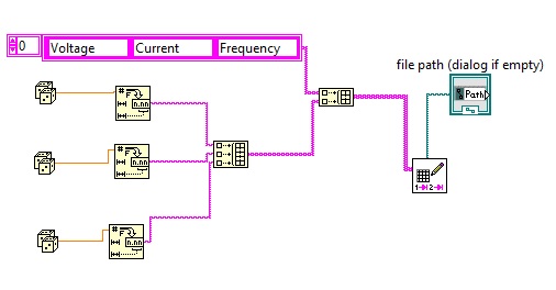

Don't use Save Spreadsheet String, but use the Write Delimited Spreadsheet function from the File I/O Palette.  Incidentally, I hope you realize that "Spreadsheet" in "LabVIEW-Speak" means "A text file where data are arranged in rows (with New Lines) and columns (with some to-be-specified separator character).  It does not mean "An Excel .xls or .xlsx file".

Yer doin' it wrong...

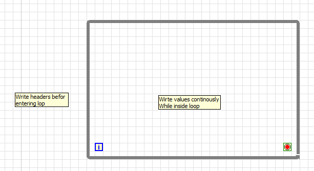

First write your column headers to the file ONCE at the beginning.
Then write your numeric values in ROWS as a single demention array
=== Engineer Ambiguously ===

How to add next values to the spreadsheet when i run program continously?
At this moment the values are overwritten.
(8,908 Views)
Accepted by topic author piotrek1349
Use a loop

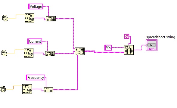

how are you writing your row of strings in the first array?
I do not understand where you get that string format of many columns from?
(7,054 Views)
Hi lodhi,
When you write "columns" you should think of "array"!
Use a string array constant…
