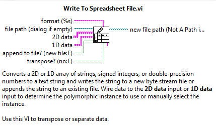

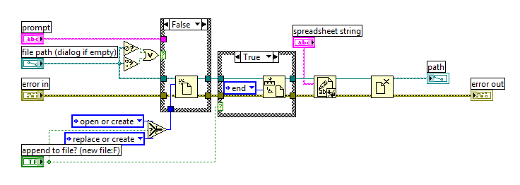

Data is being written via the included "Write to Spreadsheet File.vi" in Labview. Here's the context help for it:
It is the NI file but when you open it and drill down, there is an Array to Spreadsheet string component and then the following code does the actual opening and writing of the file:
