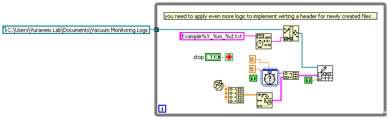

Hi Liz,
THINK DATAFLOW!
The file path is generated before the loop and so will stay the same in the loop!
You need to create the file path inside the loop and you need to apply some program logic to change the filename at midnight:

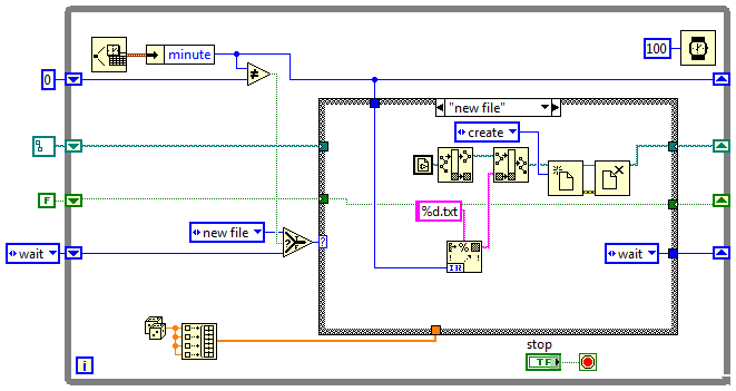

Simple state machine with shift registers, elapsed timer, comparison..Modify as necessary
new file every minute, data record every 2secs....see if you can understand the logic
Message 8 of 37
(5,457 Views)
Thanks so much. I was able to modify this to do what I needed to.
