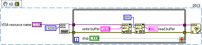

Hi usakshi,
try this:
And put a command into "write buffer" to trigger a device reply…
