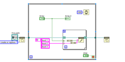

I have an array of boolean switches. I want to be able to log the state (1 or 0) of the boolean switch every second in a TDMS file. Since I have three switches, I want three separate columns that has the state of that switch. Ex:
Switch 1        Switch 2         Switch 3
      1                     0                    0
   1                     0                    0
   0                     0                    0
   0                     0                    0
How could I achieve this? Whenever I try, the TDMS file just has all the values in one column. Any help is appreciated!

Here is a way to do what you want

On top of adding the Create or Replace enum input (otherwise it opens an existing file) I set the data layout input to Interleaved on the write function, and added the 1D string array like Yddet did naming the TDMS channels.  There are many installed TDMS examples in the Help >> Find Examples tool.
